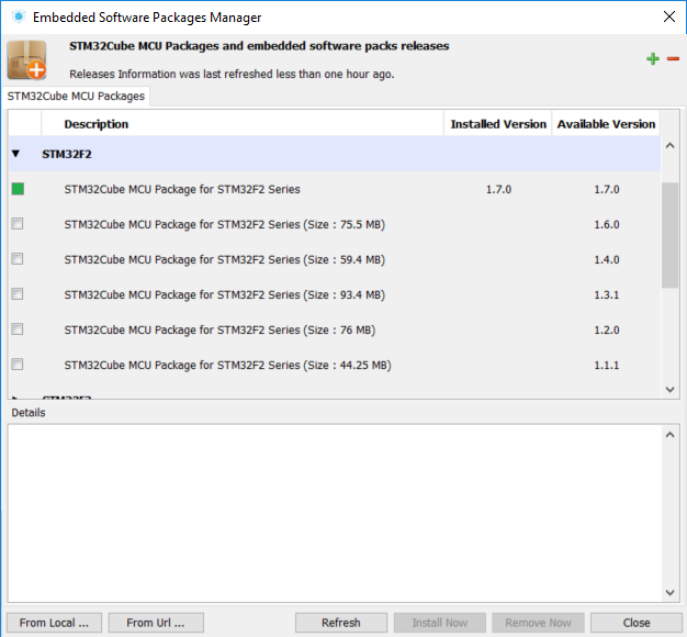

I am looking for 1.1.3.
I see the CubeMX has an option to check off versions, but there is no 1.1.3:
2018-03-12 10:20 AM
So I cannot help then. Maybe someone have it on a private drive OR someone from ST is willing to share it.
