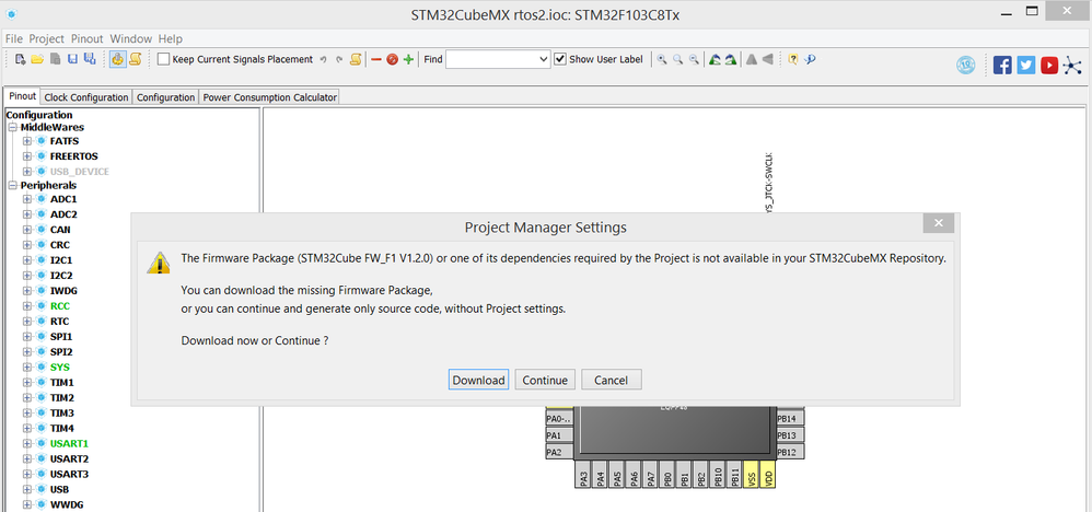

CubeMX has v1.3.1 of my F1 library so I edited the ioc file and entered the 1.2.0 to stimulate the CubeMX to use older package and make it download the package:
ProjectManager.CoupleFile=false
ProjectManager.CustomerFirmwarePackage=ProjectManager.DefaultFWLocation=trueProjectManager.DeletePrevious=trueProjectManager.DeviceId=STM32F103C8TxProjectManager.FirmwarePackage=STM32Cube FW_F1 V1.2.02018-01-12 1:49 PM
Try this trick:
-generate simple project file using CubeMX
-close the CumeMX
-edit the project_name.ioc file, find something like that(this one is for F103): ProjectManager.FirmwarePackage=STM32Cube FW_F1 V1.2.0
-replace the the number with the one you are looking for
-start the CubeMX
-generate code - the CubeMX will complain about lack of the librarry you are using and will download the library
It worked for me for F103
