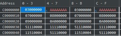

I simply wrote 0xAAAAAAA to the location 0xC00000004 and the data in 0xC0000000C updated at the same time.
Any suggestion on this issue? Thanks in advance.
2021-02-03 3:10 PM
FYI, here was the solution to this issue:
"We ended up by replacing a new SDRAM and resolved the problem, it seems highly likely the fault was caused by a bad soldering on the BGA SDRAM."
Hugues
2021-02-02 1:32 AM
Sounds like short or bad solder joint on A1 (either memory or STM32), or A1 not configured correctly in GPIO.
Check former by measuring, latter by reading out and checking the respective GPIO registers.
