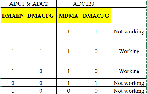

In the reference manual, it is showing that for the dual-mode circular mode we need to use the DMA related bits in the ADC12_COMMON -> CCR instead of DMA bits in ADC1 -> CFGR.
For me, this DMA transfer in circular mode is working properly only when DMACFG is enabled in ADC1 -> CFGR and ADC2 -> CFGR but not when enable in ADC12_COMMON -> CCR?
I believe there are some bugs in the dual-mode implementation document provided by ST.
Below cases tested, few cases working and few not working.
Any proper example to refer to or procedure to do?
