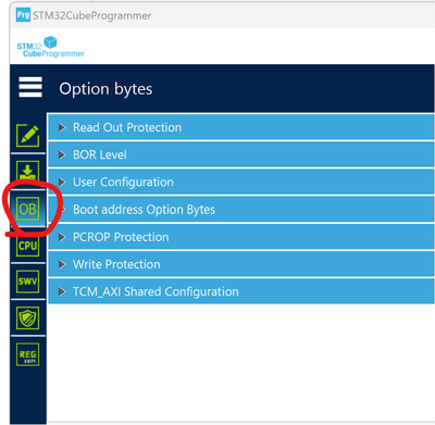

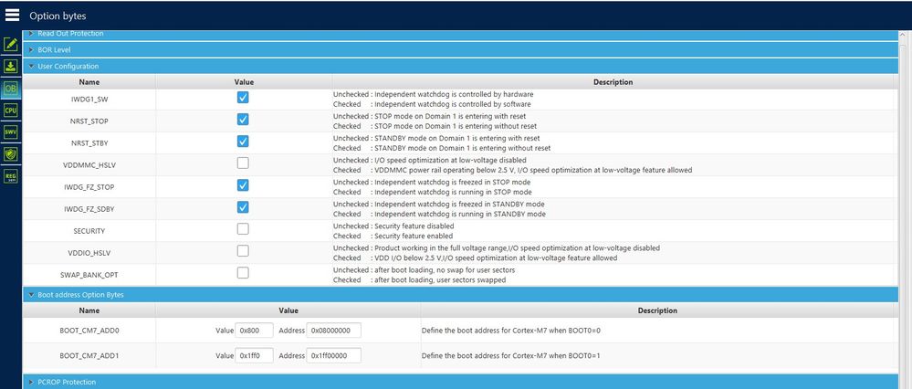

And per @TDK I checked the Option bytes in CubeProgrammer and nothing looked wrong to me. Here's what I think it the most pertinent part. If there's something else I should be checking, please let me know.
And I compared all the option bytes for my main app running on my custom board and the option bytes for the blinky program running on the Nucleo board and they were identical.

Okay, getting somewhere. Option bytes seem okay.
