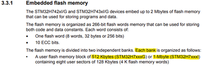

STM32H743VGxx officially has a hole after 512KB, between bank1 and bank2. But! The hole does not have to exist. This can explain why CubeProgrammer and the debugger behave differently. Officially, your .ld file that does not have the gap after 512KB is wrong for H743xG.
2024-08-06 6:43 AM
So,what I can do when my code size is over 512K?
2024-08-06 6:56 AM
Divide it to two blocks: 512K in bank1, and 512K in bank2. You can also use the undocumented space in the gap between the banks, on your own risk.

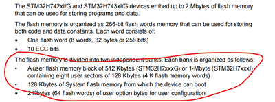

Why FLASH2 start address is 0x08100000?
0x08000000 ~ 0x08100000 is 1024kbytes.
2024-08-06 6:07 PM
about this description,we don't know valid address range can be used for user code/data.
