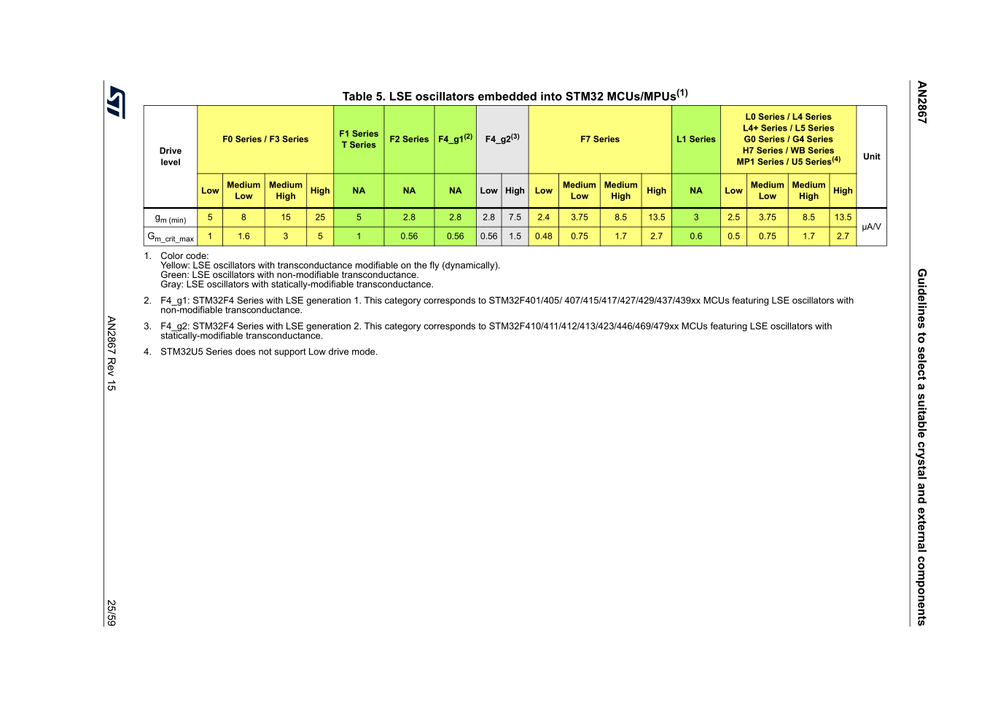

Where is the List?
Best Regards
2021-12-04 3:05 AM
In AN2867:Also in footnote to Table 7.
