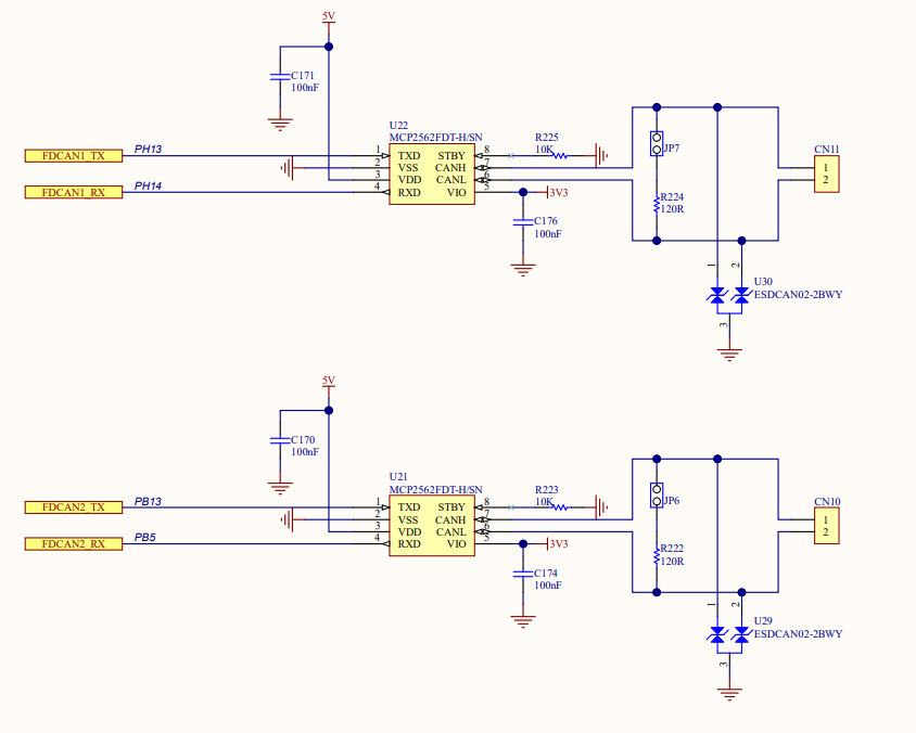

Hi Peter,
Thank you and for STM32H745I-DISCO Discovery Kit this kit, does it integrated PHY (transceiver)?
MA JIAN
2023-04-26 10:53 PM
Yes, as you can see in the schematics of the MB1381, this DISCOVERY also includes the FDCAN transceivers (PHY), one for each of the two ports.

2023-04-28 2:14 AM - edited 2023-11-20 7:20 AM
You don't need to add transceivers as STM32H745I-DISCO Discovery board features already two transceivers MCP2562FD which can support up to 8 Mbps Operation. Also you don't need to add termination resistors of 120ohm:
