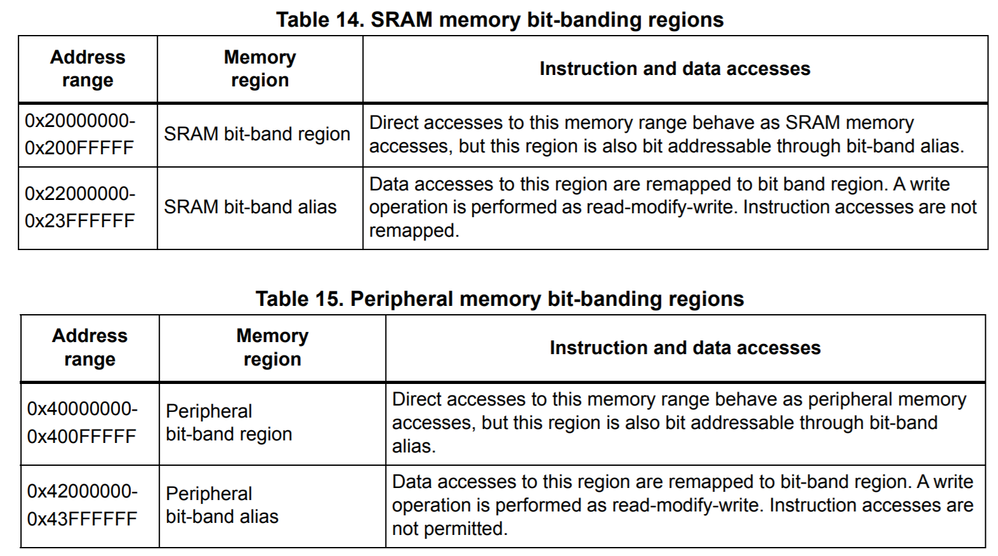

What are the SRAM bit band area address and its bit band alias area address, and the peripheral bit band area address and its bit band alias area address, if supported?
2020-12-07 8:04 PM
There are address ranges mentioned in the Cortex M4 Programming manual -
2020-12-07 8:06 PM
Bit banding addresses are shown in the programming manual. Not everything is bit banded.

2020-12-07 11:46 PM
"Does STM32L431 support bit band operation?" - yes (it does)

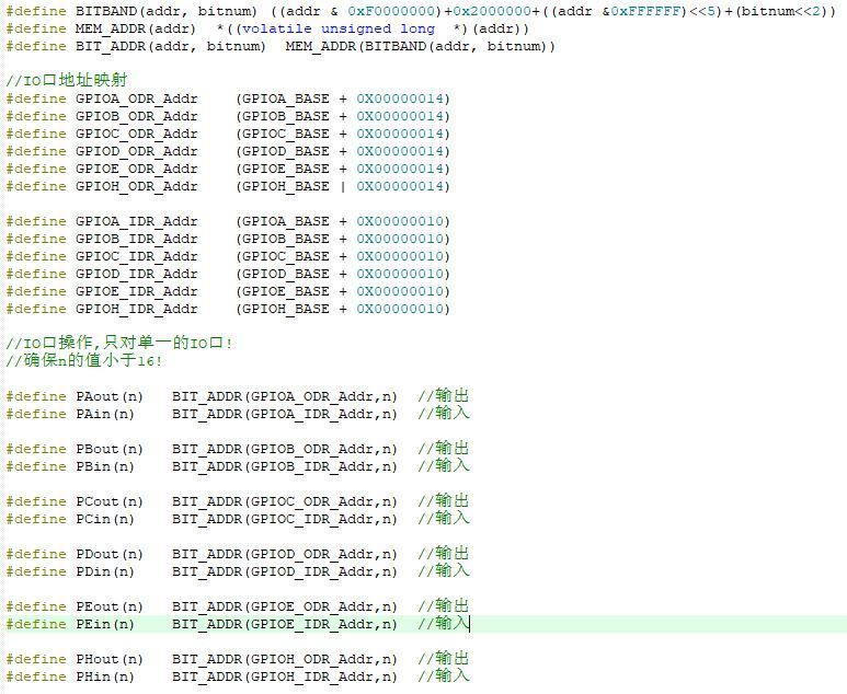

2020-12-08 12:24 AM
My programming looks like this, but it doesn't work
2020-12-08 12:52 AM
So, are the GPIO addresses within the area which is bit-banded (see TDK's post above)?
