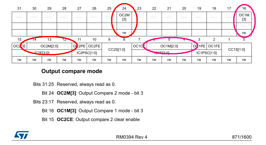

For starter, you can try to configure the two neighbouring channels independently for plain PWM in the clicky, and then manually overwrite TIMx_CCMRx_OCxM of one of them for the Combined PWM mode. For extra fun, you can do this without writing any code, simply in the debugger, while observing the effect on the output pins.
Note, that the OCxM field is for historical reasons non-continuous
