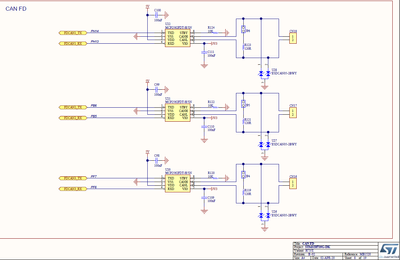

From the board's schematics you have three CAN interfaces on the board each one having its own transceiver:

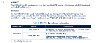

From the board's UM2679 :
So read carefully the "limitation" section.
