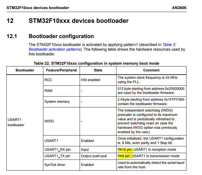

I read this application note, but it just said use USART1 in stm32f103,it does not mention wich pin's should be use?
pin (A9,A10) or (B6,B7)?

Hi
Sadati.Danesh
,Please refer toTable STM32F10xxx configuration in system memory boot mode
