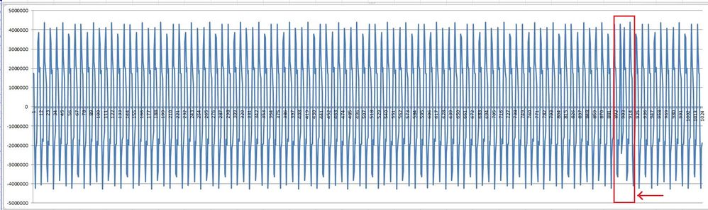

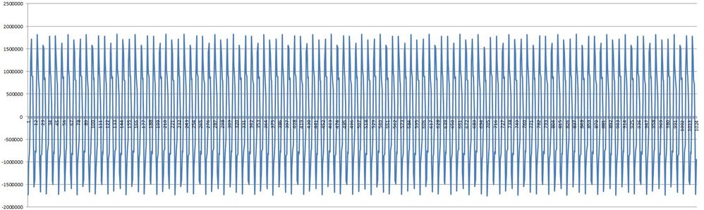

I couldn’t use SPI with ADS1274 because of its high sampling rate. So I decided to use SAI interface. It is completely suitable with ADS1274 and I didn’t have any problem (I could get interrupt from DMA and obtain SAI data that transferred by DMA). But when I plotted 1024 samples, I saw that some samples are absent. And then, I collected more samples by Saleae Logic Pro. and compared them.
As you see from picture abowe, there are some absent samples (with STM32F765VG).
As you see from picture abowe, there isn't any absent sample ( with Saleae Logic Pro.).
I think, my DMA gives me wrong data sometimes or it misses some samples.

Thanks for your reply @Piranha. I solved it. The problem is related with adding break point while system runs. I did many different tests. So I realized that if I double clicked line 104 to add break point while system runs, vBuf is bad (as I mentioned before). But if I click pause button, I saw that vBuf is perfect (as I expected). As a result I decided that I won't double click to add break point while system runs.
