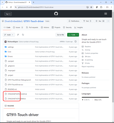

@MNapi wrote:The codes are written not for STM32
Really?

Thank you @Andrew Neil
I am new to STM32, touch displays and the entire ST development environment.
Is that driver compatible and ready to use with TouchGFX "out of the box"?
Thank you :)
