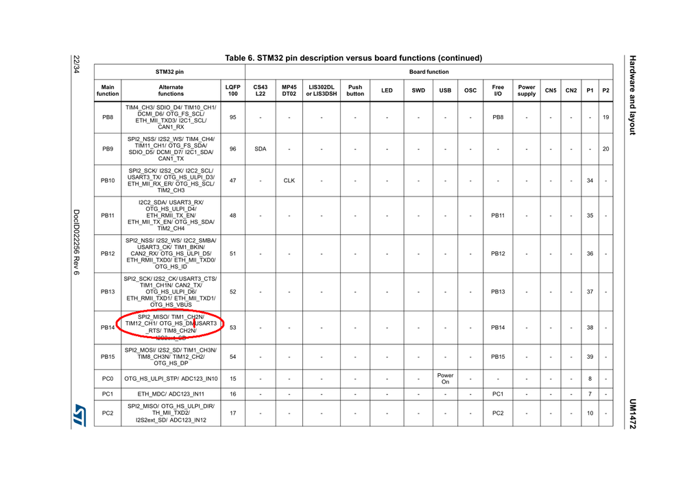

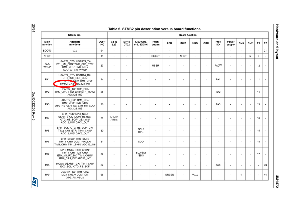

2017-07-24 7:37 AM
There's a typo in Table 6:
2017-07-26 9:16 AM
Hi Jan,
Thanks for bringing this to our attention
This is highlighted internally and will be fixed in next releases.
Khouloud.
2017-10-06 8:34 AM
One more:
OTG_HS_DM and USART3_RTS stuck together there.
