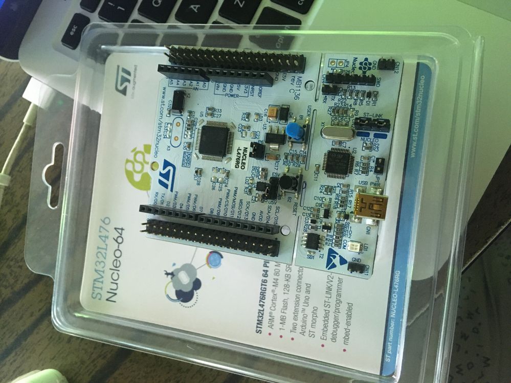

Luckily, I have purchased the same model hardware i.e. nucleo board even before I came across this step by step tutorial.
The step by step guide is only for Windows machine where as I use a MacOS from which one can understand I have done some ground work to get the things up and running. Looks like the docs are now outdated or the mac environment is different.
I have followed all the 5 pdfs, reference document links are provided when and where required, for example : USART - a brief explanation pdf was provided. This was helpful to understand what it is exactly.
Sadly, I was not able to debug as the ST-Link server application is not compatible with mac catalina and I was stuck there. I was able to just execute some example code by generating and pasting the .bin/.hex file on the virtual port of the dev board.
Although I have imported the code into the STM32CubeIDE (MacOS), I am waiting for a chance to test it on full fledged manner on the dev board.
There is no official reply from ST team about when the patch for the ST-Link server would be available for Mac OS Catalina.
