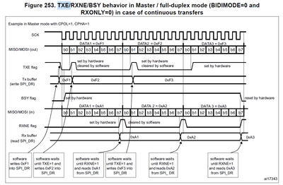

I guess you're right. I really though it could be 32-bits on the F4, but maybe I've been using the H7 too much lately. I guess you could chain the second transfer off of the TC trigger without too much trouble or delay.
2023-06-29 6:46 AM
What you wrote will probably work okay if the SPI clock rate is high, but just because TXE=1 the transmission may not be complete. You should wait for BSY=0 after the final transfer before you pull CS high.
