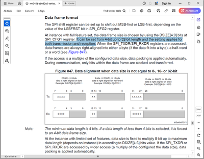

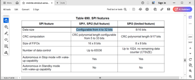

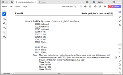

U5 has also 32 bit SPI.
2025-01-17 3:01 PM
U5 has 4..32bit!
reference manual, page 2888, 68.2:
"From 4- up to 32-bit data size selection or fixed to 8-bit multiples"
page 2904:
As I understand:
