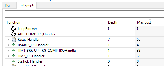

Thank you for your reply. I checked first 4 of your advices and those are all correct but I have problem with the last one. I created this project in STM32CubeIde and it provides linker and startup files. There is a section like below in the startup file, and code stuck in there.
LoopForever:
b LoopForever
.size Reset_Handler, .-Reset_Handler
* @brief This is the code that gets called when the processor receives an
* unexpected interrupt. This simply enters an infinite loop, preserving
* the system state for examination by a debugger.
* @param None
* @retval : None
.section .text.Default_Handler,"ax",%progbits
Default_Handler:
Infinite_Loop:
b Infinite_Loop
.size Default_Handler, .-Default_Handler
I couldn't realize that infinite loop is not my for loop in the main. Its my bad sorry. This pictures are from stack.
I dont have ADC_COMP_IRQHandler, should I have? I checked the project that is created by STM32CubeMX with HAL libraries and it doesn't have ADC_COMP_IRQHandler.
