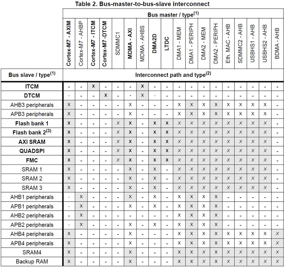

According to the bus matrix/routing diagrams DMA1 can't access DTCMRAM, and thus the error
Suggest using 0x24000000 AXISRAM or 0x30000000 (SRAM1,2,3)
You might also want to configure the MPU related to write-thru and caching, or manage the cache more directly to address coherency issues.
