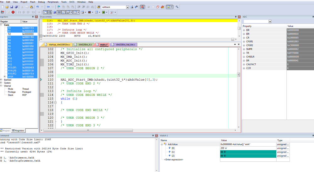

Hello. I am using STM32L053R8T6. I connect 3 ADC channels (PA4, PA6, PA7). For this I use DMA. I need the resolution of the ADC - 8 bits, for this I initialize an array with the dimension of 8 bits (volatile uint8_t AdcValue [3];)
I am using DMA HAL_ADC_Start_DMA (& hadc, (uint32_t *) & AdcValue [0], 3);
Next, I look at the debugger in the Watch window
and at the minimum position of the resistor connected to the ADC, I get a value of 255, and at the maximum position of the resistor I get a value of 65. Why is this happening?

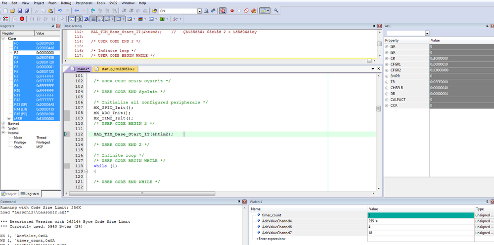

2018-10-24 4:29 AM
I tried to process 3 ADC channels (PA4, PA6, PA7) singly by running single transforms in the timer handler and received values (4-255).
That says about the working scheme, but in the case of DMA, I get the minimum value of 65. What could be the problem?
