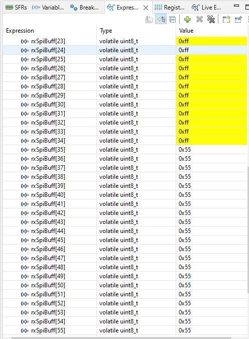

We have the DMA SPI TX direction working but are having issues with the data that is being returned. Technically this is a read from the EEPROM but the command and read address are sent first. The EEPROM responds with the 32 bytes of blank(0xFF). None of the data ends up in the DMA SPI RX buffer. When the DMA TX complete interrupt completes(when it's done transmitting 0x00 so we can receive data), the is nothing in the DMA buffer or even a 0xFF in SPI data register itself.
The SPI is configured for full duplex and we have the DMA TX buffer(35 byte size) send out the read command and then 32 0x00's(three byte command + 32 blanks) so that the clock runs for the incoming data. The RX DMA is set to 32 bytes(3 less bytes.) This was done in the hope we could use the DMA RX transmit complete interrupt to know when the entire read of the data from the EEPROM was done(as suggested by @Nikita91 from this thread: detecting-the-complete-end-of-spi-transfer-in-tx-master-mode.) We are very new to SPI and a lot of data sheet nomenclature is confusing because when you are the master in full duplex mode, you are transmitting data to receive data.

Update
We decided to move the DAC output from channel 2 to channel 1. This move involved changing the GPIO pin from PA5(pin 22) to PA4(pin 21) and configuring DAC channel 1 to receive the DMA data instead of DAC channel 2. We used a O'scope to insure the sine wave output was being sent correctly as pin 21 is not connected to anything.
SPI RX DMA data now seems reliable as we have run the test 50 times and all tests pass. This looks like an internal issue between the DAC's channel 2 and SPI RX. When we receive guidance from ST we will update this thread.
ST has found our issue. We simply missed the pin assignment. When we read Table 12 of the data sheet, PA4's DAC_OUT1 is listed under the "Additional functions" column right next to the "Alternate functions" column. We configured it as a alternate pin assignment instead of a analog pin assignment as show in some of their Low Level driver example code. The DAC output still works and things are fine until the SPI is run(which is one of PA4's alternate pin configurable s.)
Thanks ST.
