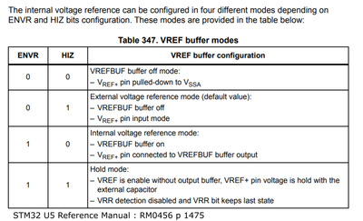

First, make the difference between Vref+ and VREFBUF: see this page for better explanation
So when you talk about "VREFBUF outputs" I assume that you means VREF+.
"HIZ" bit defines if VREF+ output is high impedance or low impedance.
If you want to output VREFBUF voltage to provide reference externally you must set HIZ = 0 and ENVR = 1.

From my side I managed to change HIZ bit by changing the configuration of VREFBUF in CUBEMX. The HIZ bit value matches the configuration name on the table I sent earlier.
In the code itself the bit is set in the file stm32XXxx_hal_msp.c : (example VREFBUF in hold mode)
