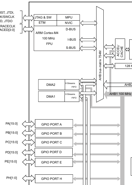

look at an F4, i tried the F411 at 100MHz core clk, producing a 10ns pulse on port pin (BSRR...) ; with optimizer on speed (-Ofast) , without optimizer get about 50ns .
here ports are "close to core" on AHB1 :

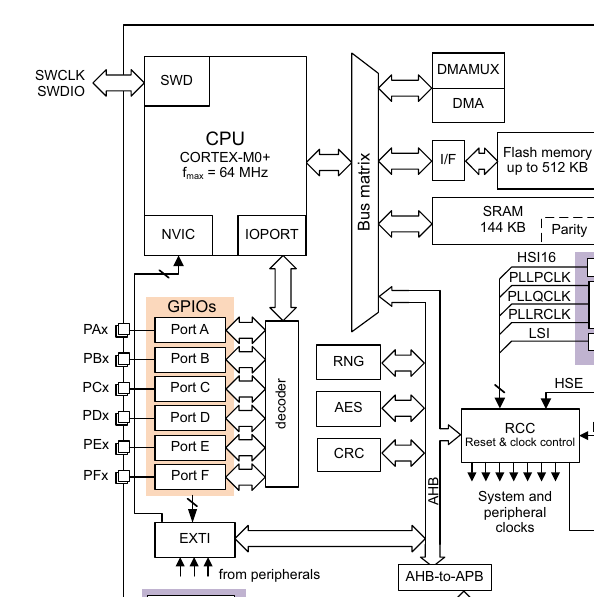

or on a new M0+ core , ports direct to core (but cannot accessed by DMA here ! )
