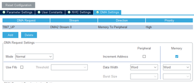

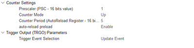

To achieve this I set timer 7 to have an update even every 100nS then I set DMA2 stream 0 in memory to peripheral configuration.
The idea is to create a buffer, with the signal timing, and then set the DMA2 to transfer that buffer to the BSRR register of the port I have connected to the leds.

Since I won't be updating the leds often, I don't want to create a circular buffer and load the DMA all the time. That's why I wanted to do a normal buffer, execute it once and execute it again when I need to change the colors.
