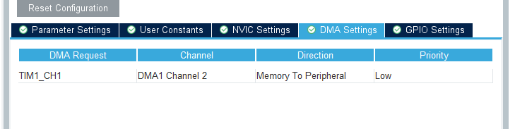

HAL_TIM_PWM_Start_DMA(&htim1, TIM_CHANNEL_1, (uint32_t *)pwmData, 10); I have DMA setup for the timer

Red out and check/post content of TIM and DMA registers.
