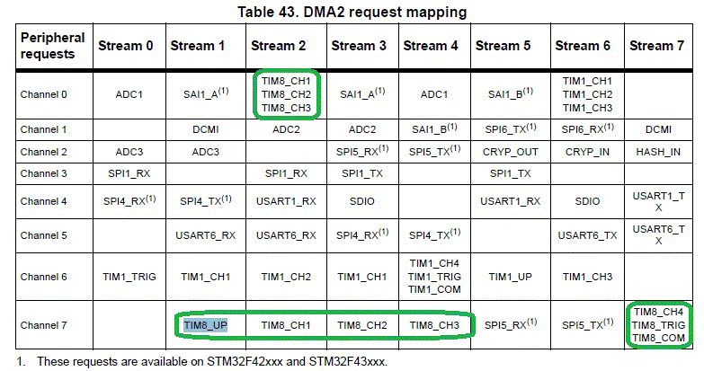

Is it possible for a DMA to be both MemoryToMemory and have the rate of delivery be set by a timer? ie: I'm effecting a copy from an array in RAM, to a GPIO. (a byte at a time, say, otherwise I could use SPI tricks.) With MemoryToPeripheral I think you can do it, but is M2M full speed only? Or is it possible to refer to a GPIO as a peripheral somehow? Thank you my friends, jeff #stm32f4-dma2014-06-11 6:03 PM

For TIM8 the channels/streams are defined in the Reference Manual RM0 The specific pin designations for the channels can be found in thehttp://www.st.com/st-web-ui/static/active/en/resource/technical/document/datasheet/DM00037pdf
