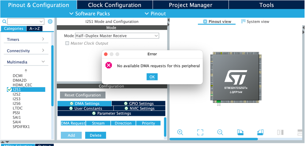

I tried everything but keep on running on the same issue:
In the reference manual it describe the DMA for the I2S, so I'm quite sure it is possible to enable it.
Please help me.
2021-10-12 5:38 AM
Indeed, It is the latest version. I am facing the same issue than yours. DMA is for sure usable even for the half duplex mode.
I am going to see to rise up this issue.
In between, you can set-up the DMA like described in SPI HAL library examples embedded into the STM32H7 firmware library.
BR,
Christophe
2021-10-12 1:01 AM
Which is the version of CUBEMX you have in your own ? Is it the latest ?
BR,
Christophe
2021-10-12 1:59 AM
It is the 6.3.0. It should be the latest.
2021-10-12 5:38 AM
BR,
Christophe
2021-10-12 5:52 AM
I add confirmation that this point had already been highlighted and analyzed with a validated fix forcasted for next revision 6.4 of CUBEMX.
BR,
Christophe
2021-10-12 6:28 AM
Thank you for the reply.
I hope the new release will be updated soon.
Best Regards,
Luigi Lavriani
2021-10-12 7:14 AM
You are more than welcome.
Best regards,
Christophe
2021-11-25 9:51 AM
Is the update release date already known? I'm having the same problem...
