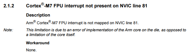

See this item in the errata
2020-06-02 2:24 AM
Oh my god ! Thank you, completely missed this point. I usually look to the errata for peripherals but I forgot there can be errors in the core itself...
2020-06-02 2:28 AM
However the errata is about the mapping of the FPU interrupt in the NVIC but I was more looking at the flags in register FPSCR. These flags are completely independant from NVIC. So they should be set anyway ?

I assume this debugger inaccuracy might be linked to the Cortex FPU implementation error mentioned in the STM32H7 errata sheet ?
