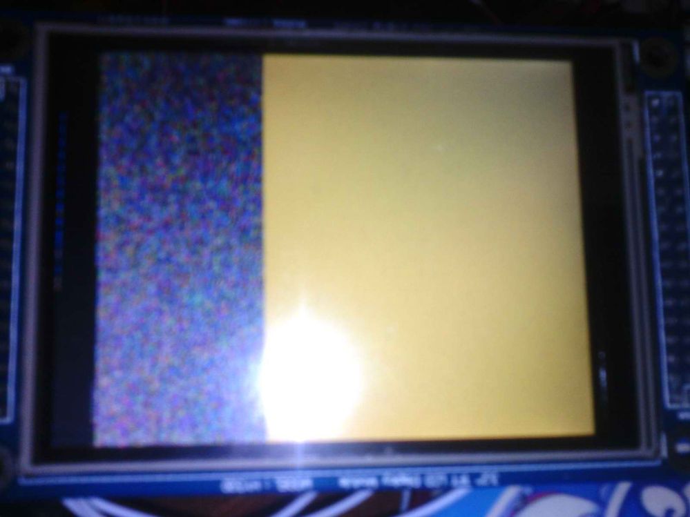

any examples ?
I used this function and got stripe on LCD, thanks

2014-04-14 9:54 PM
this is the result for the code
