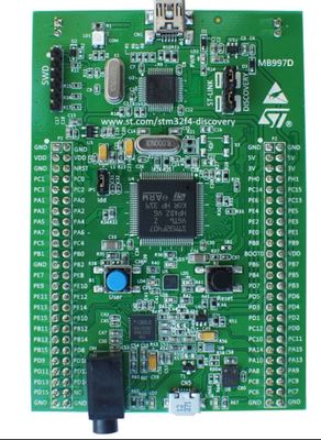

The CN3 jumper is on or off? Can you add more details about your issue. Is the board detected by the PC? What is the Connector you are using? If you can provide a clear picture to your configurations?

The stm32f407-disco containe only a USB OTG Micro-AB connector (CN5)on the bottom of the board.And a mini B USB connector (CN1) on the head of the board.
If you are using the CN5, You can't connect the board to your PC, is just a power supply (ld2 on and ld1 off). If you are using the CN1, than you can connect your board to the PC using the ST-LINK/V2.
