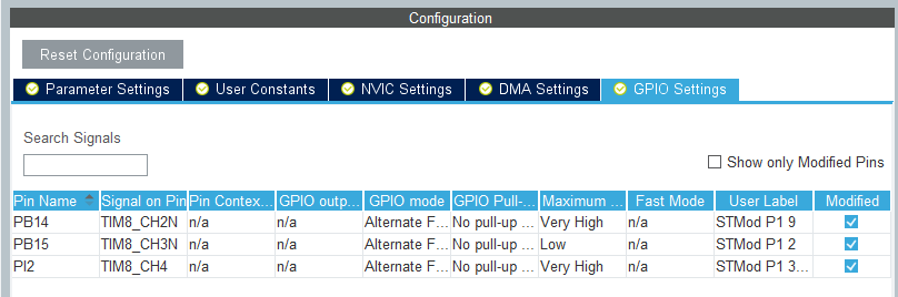

I think I am missing something obvious about a difference between channels 2&3 vs channel 4 in the TIM8 after staring at this for some hours now...
I am using the STM32H750 discovery board, and created a project in CubeMX which configures PI2, PB14 and PB15 as PWM outputs for channels 4, 2, 3 of timer 8. (ignore the maximum frequency, I changed it after taking this screenshot)

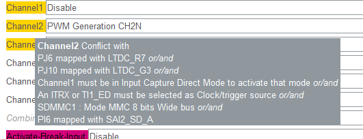

CubeMX provides a warning about a conflict for PB14 and PB15 assignment, but I can't tell which potential conflict is the real one.

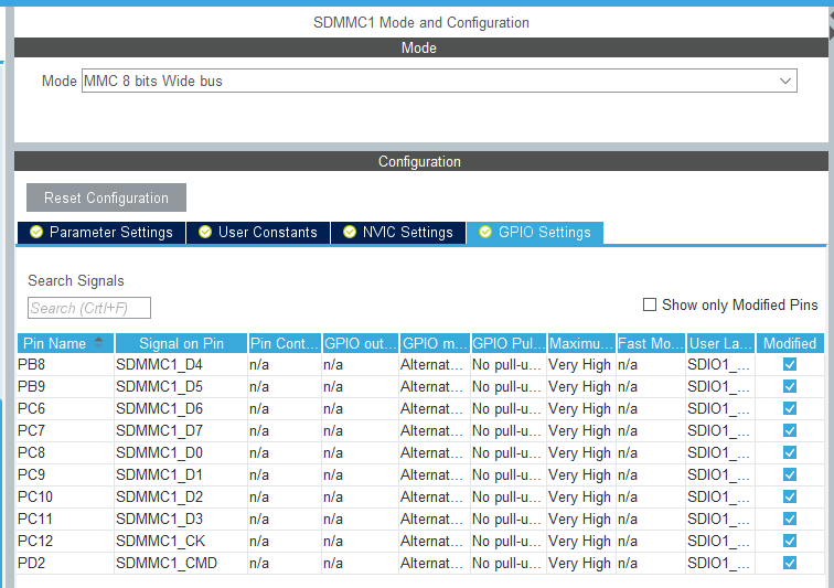

The SDMMC is enabled but not using these pins:

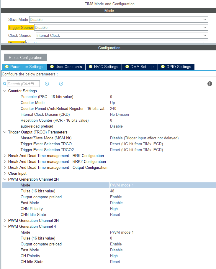

I don't think it is ITRx nor TI1_ED because I'm using the internal clock source and no external triggers:
Break and dead time functions are all disabled in the configuration. Looking in the description of the timer in the reference manual (figure 344 of RM0433) it seems like these channels should be configured with the same behaviors. But when I run my program (even just using the default PWM duty cycle I have configured in the CubeMX) the pins PB14 and PB15 have no PWM output.
