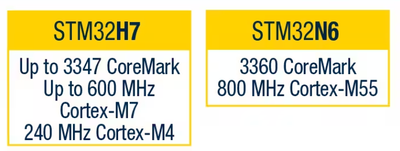

Hi @DJ_IND
Regarding CPU performance alone, you can find the Coremark scores on the specific product datasheets.
Comparing to STM32H753, the STM32N6 also includes many new additional peripherals.
Such as the H264 video encoder, DCMIPP, Neo-Chrom 2.5D GPU and the Neural processing unit.
There's also a 1-Gbit Ethernet PHY and Octo/Hexa SPI communication interface.
