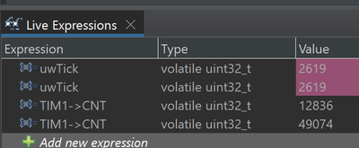

Logically, the CIRCULAR setting will not affect data getting into the buffer via DMA in a single pass. No mechanism for that. But since you set a breakpoint, and then read out the data, it seems like the data should be from a single pass. But maybe it's not.
Is DMA happening in the background when the chip is paused? Add new live expressions that show the same values. Are the value different? That's likely the issue. For example, I added "TIM1->CNT" twice here while at the breakpoint. Timer runs in the background, so value constantly changes but it only updates once when at the breakpoint.

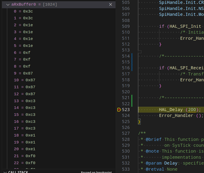

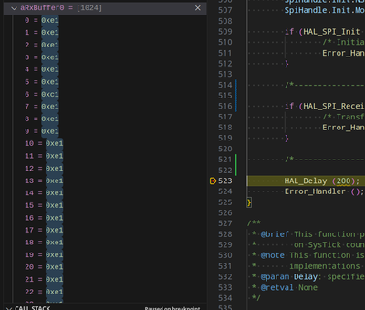

Thanks guys.
> "What are the exact values you're receiving and why do you think they're off?"
In DMA_NORMAL, with SPI1 running at 54MHz, and function gen. feeding 6.75Mhz square (6.75 == 54/8) i get:
As you can see we get 1e, 1e, 1e which in binary looks like 00011110 00011110 00011110 00011110 .... so IMHO this what it should look like. But the moment I replace DMA_NORMAL with DMA_CIRCULAR (or I play with double buffer mode which in turn enables circular mode) i get:
When I try to convert these to binary I get something like:
11110000
11110000
01111000
01111000
00111100
00111100
00011110
00011110
00001111
00001111
10000111
10000111
10000111
11000011
11000011
11100001
11100001
11110000
11110000
11110000
01111000
00111100
00111100
This is why I think "something's off"

Thanks everybody! I think TDK got it right! I added __HAL_DMA_DISABLE (hdma); in SPI_DMAReceiveCplt and set a breakpoint just after disabling the DMA and everything works smoothly now. I see all 0xf0 values even with circullar mode. The problem is that previously GDB was reading the 1024 long array much slower than DMA was storing values into it. And due to small clock difference between my function gen and the board itself I saw this "drift".
