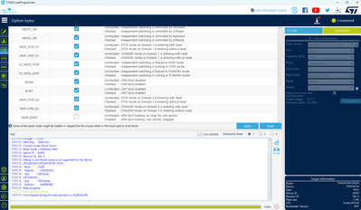

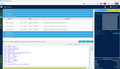

Hello @FabianEbs and welcome to the community.
Check if you have disabled the Cortex-M4 using CubeProgrammer in option bytes menu.
2024-08-26 7:02 AM

2024-08-26 7:21 AM
Yeah that worked.
I did another full chip erase followed by programming the .elf file of an example project, both in STM32CubeProgrammer under Erasing & Programming.
Afterwards I was able to flash directly from STM32CubeIDE again.
Thanks a lot everyone!

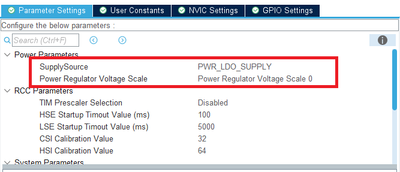

Indeed this is a wrong configuration with your RCC:
First, STM32H745I-Discovery is mounted in SMPS by HW while you set the power config to LDO.
Second, you cannot exceed 400MHz @VOS1 in SMPS with that microcontroller.
Attached an updated ioc file. Please test and get back with your findings.
