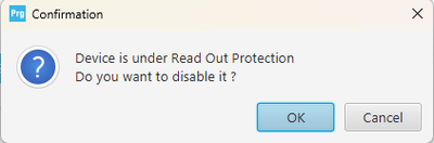

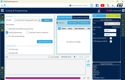

I a developing a custom product were the partition is like Bootloader + APP1 + Partition 2 , were I Integrated the DFU library into bootloader and which is successfully enumerated in PC without any errors. My goal is do the flashing .bin file into app1 partition using this USB DFU. But I couldn't even connect the the device. Attaching the screenshot and logs for your reference.
the MCU is stm32h563rgt6 with 1mb of flash.
Bootloader size: 128kb //0x08000000
App1 partition size: 384kb and //0x08020000
Partition2: 384KB ////0x08080000
this also asking when trying to connect
and I proceeded with OK
please see the logs from STM32 Cube programmer
15:53:40 : UR connection mode is defined with the HWrst reset mode
15:54:11 : USB speed : Full Speed (12MBit/s)
15:54:11 : Manuf. ID : STMicroelectronics
15:54:11 : Product ID : STM Device in DFU Mode
15:54:11 : SN : 336E36833233
15:54:11 : DFU protocol: 1.1
15:54:11 : Board : --
15:54:11 : Device ID : 0x0484
15:54:14 : Disabling memory Read Protection...
15:54:14 : Memory Read Protection disabled successfully
15:57:41 : UR connection mode is defined with the HWrst reset mode
15:57:41 : USB speed : Full Speed (12MBit/s)
15:57:41 : Manuf. ID :
15:57:41 : Product ID :
15:57:41 : SN :
15:57:41 : DFU protocol: 1.1
15:57:41 : Board : --
15:57:41 : IAP
15:57:41 : UPLOADING ...
15:57:41 : Size : 885760 Bytes
15:57:41 : Address : 0x8000000
15:57:41 : Read progress:
15:57:41 : Error: Data read failed
15:57:42 : Warning: Connection to USB device is lost
15:57:42 : Disconnected from device.
