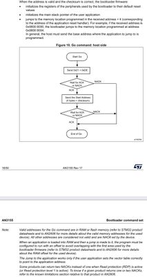

Going through AN3155, the Go Command (0x21) seems to be the answer i was looking for, but although i am getting the desired ACK, the program fails to execute and i still need to reset manually.

Dear @rcohe.1 ,
Can you let us know if you managed to get your application jumping using Go command .
there are few notes for “valid jump address” below on vector tables .
Thank you for the feedback.
