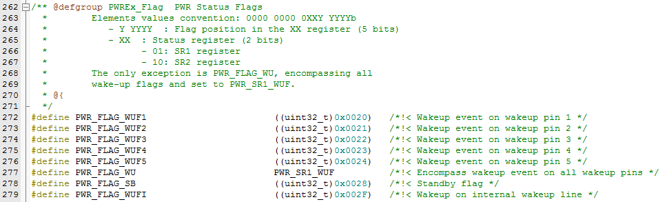

For shutdown mode, when wake up source is a wake up pin, you can simply check wake up pin flag to detect that MCU has been woken up, for example like this:
if(__HAL_PWR_GET_FLAG(PWR_FLAG_WUF1) != RESET)
{ //if we are here, it means that MCU woke up from shutdown __HAL_PWR_CLEAR_FLAG(PWR_FLAG_WUF1); }Some flags, which can help you to work with waking up from low-power modes you can find in stm32l4xx_hal_pwr_ex.h file:
I know it is not a direct answer to your question, but maybe this hint can help in your case.
