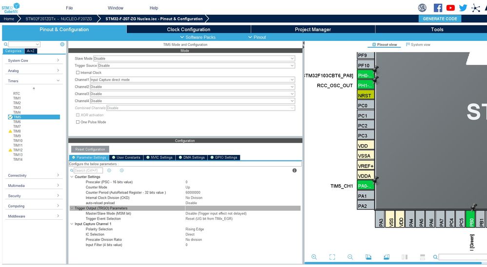

Ok. Now i am using pwm generator and feeding it to PA0 pin of STM32F207ZG nucleo board. I want to measure 1 HZ to 80KHz frequency...

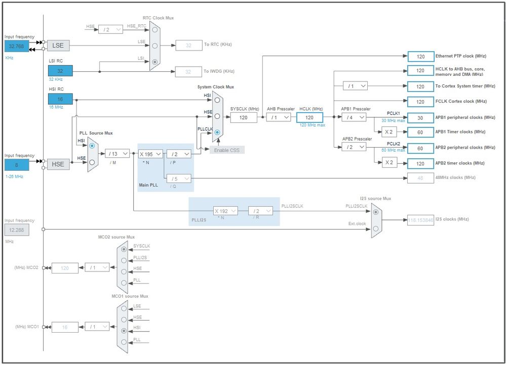

The timer clock settings are as below
Below is my timer5 setting..
Below is my interrupt code to measure the difference between two rising edge...

}The problem is that it is showing almost half the frequency and the accuracy is also low. Suppose for 100Hz input pulse it shows me 48 Hz. Any idea where i am going wrong and how to improve the measuring accuracy ?
NOTE : I am using nucleo board and i am using internal crystal. Do i need to use external crystal for better accuracy and timing performance ?

What is "internal crystal"? HSI? If yes, it's not very precise, see datasheet.
If you use a non-1 APB divider, the timer's clock is twice as much as APB clock, see RCC chapter of RM.
