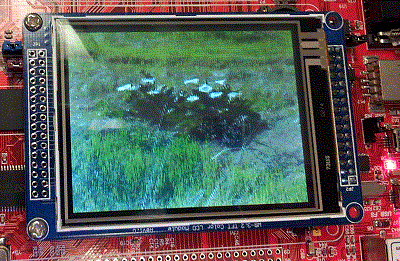

Does anyone of you have experience on decoding bmp ? I want to display bmp file to my LCD... Any clues ? thanks #i-have-a-clue2014-04-18 5:06 AM
Ok, I have the manual for the SSD part, do you have any manual/documentation/schematics for the BOARD you are using?
Can you see and image of the flowers, but with the wrong colours? I can't make out anything through the flash glare. Perhaps you have some #defines for RED, GREEN or BLUE colours passed to the functions you are using? Or a cite to the library/code?2014-04-18 5:21 AM
Yes I can see flower but the color is not right,
Yes I have define : #define Blue 0x001F #define Red 0xF800 #define Green 0x07E0 I attached the schematic, please check it out, thanks ________________ Attachments : schematic_stm32.jpg : https://st--c.eu10.content.force.com/sfc/dist/version/download/?oid=00Db0000000YtG6&ids=0680X000006I1I8&d=%2Fa%2F0X0000000bkr%2Fdneyq8Z1q_k5BZnBTOBusZpTZSKu41Lfl2osoufSjeA&asPdf=false2014-04-18 6:08 AM
// RRRRRRRRGGGGGGGGBBBBBBBB 8:8:8
// RRRRRGGGGGGBBBBB 5:6:5
pal = ((pal & 0xF80000) >> 8) | ((pal & 0x00FC00) >> 5) | ((pal & 0x0000F8) >> 3);

Thanks for the info,
May I know how can you get those values ?2014-04-18 6:26 AM
I tested and it gave me the same result, only the color was changing to blueish...
do I miss something here ?2014-04-18 6:54 AM
I'm attempting to translate the colour space formats.2014-04-18 2:21 PM
From my SSD1298 panel
2014-04-18 3:59 PM
I'm using SSD1289, is it the same with SSD1298 ?
Here's the complete function I used

2014-04-18 4:09 PM

My LCD initialization code, is it the same with SSD1298 ? may I see it please ? thanks
