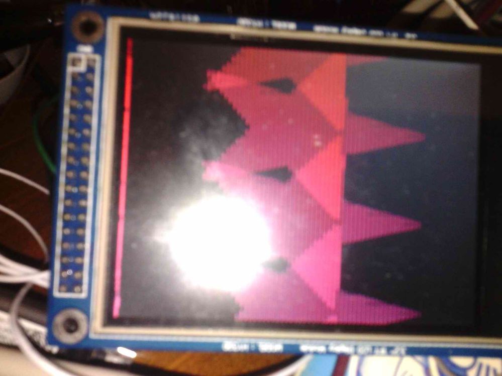

if I used
1.
for
(y=0; y<320; y++)
2.
3.
for
(x=0; x<240; x+=8)
// advance 8 pixels (one byte of bits) I got :

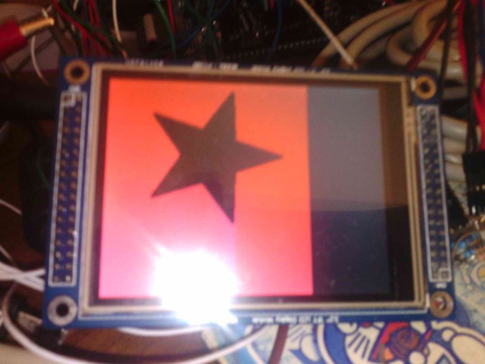

2014-04-17 6:59 PM
Thanks a lot, it works for the star, but why isn't it finished to the end of the screen ?

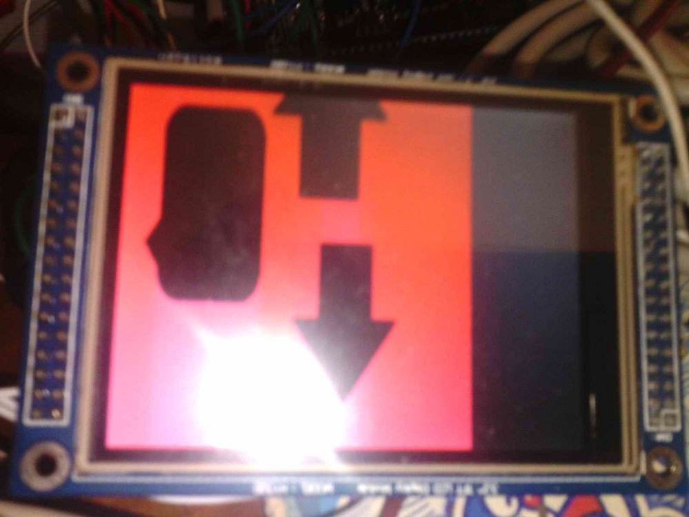

I tested with different picture, it seems that the x/y is reversed ?
originally :2014-04-17 7:20 PM
fixed :
for
(i=0; i<8; i++)
// Process bits in byte, MSB first
if
(b & 0x80)
// Pixel On?
LCD_SetPoint(y, x+i, 0xF0F0);
// Colour
else
LCD_SetPoint(y, x+i, 0x0000);
// Black
b <<= 1;
If I want to play with color, what should I change ? for example 256 color of BMP ?
