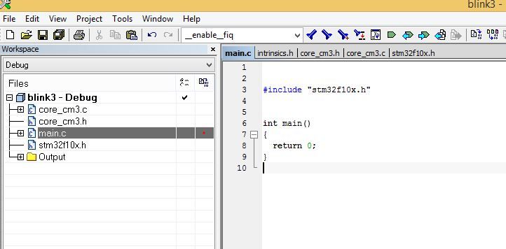

i am new in stm32 and i want to programm stm32 with spl library , but i am very
Confused because some of the Headers file include to another header file , and i dont know what is these headers setting .
i use IAR IDE - if someone has some source to learn First project in IAR with SPL , please guidance me , i am realy Confused.
however, my question is when i compile this code :
i have this error:
Error[Pe147]: declaration is incompatible with ''__nounwind __interwork __softfp unsigned long __STREXH(unsigned short, unsigned short volatile *)'' (declared at line 186 of ''C:\Program Files (x86)\IAR Systems\ D:\hossein-class\2micro programming\ARM\Activity\IAR\blink3\core_cm3.h 1186
but when i clear this line : &sharpinclude <intrinsics.h> in the core_cm3.h , i hava not any errors.
I saw declaration of __STREXH function in core_cm3 and intrinsics.h , the type of them was different.
in core_cm3 was uint32_t and in intrinsics.h was __ATTRIBUTES unsigned long ;
what do i do ??
Thanks.#intrinsics2017-10-14 7:07 AM
The F1 SPL hasn't been updated in some time (no bugs to speak of), so uses older versions of CMSIS and tools
Check if there is a 'Use CMSIS' option, or some other compatibility settings
The may be other IAR centric support venues, or the company itself, review available documentation and application notes.
