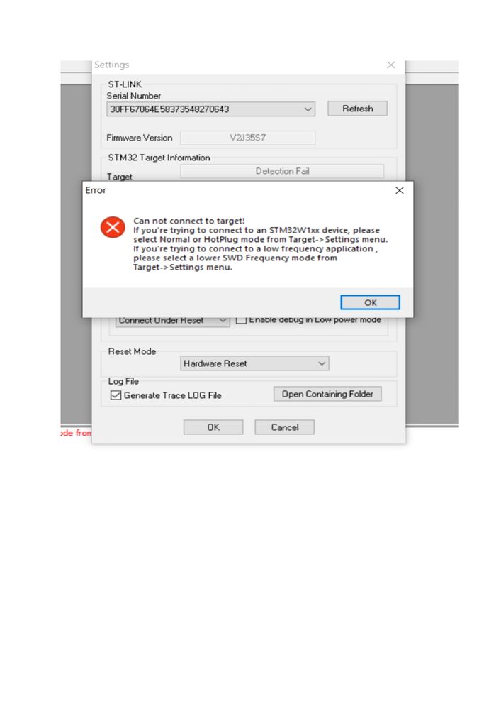

As I have tried in ST-Link utility, the below image are error are occurred. I have changed lower frequency mode and also normal mode but same error has be repeating.

What is your target? is the MCU soldered on a commerical board or a new design? Are you bringing up a first prototype?
2020-01-28 12:13 AM
Put the target into system mode via BOOT0 / BOOT1 pins, and use an appropriate tool to try a Flash mass erase.
In former time this used to be the Flash Loader Demonstator, I think the newer Cube Programmer suports the system BL protocoll as well.
ST-Link Utility supports it as well, if I remember correctly.
