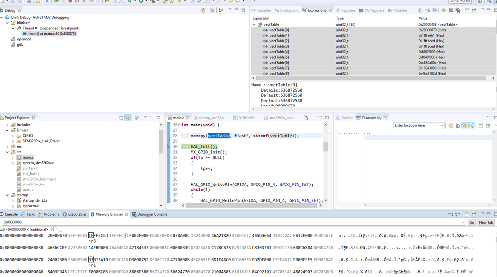

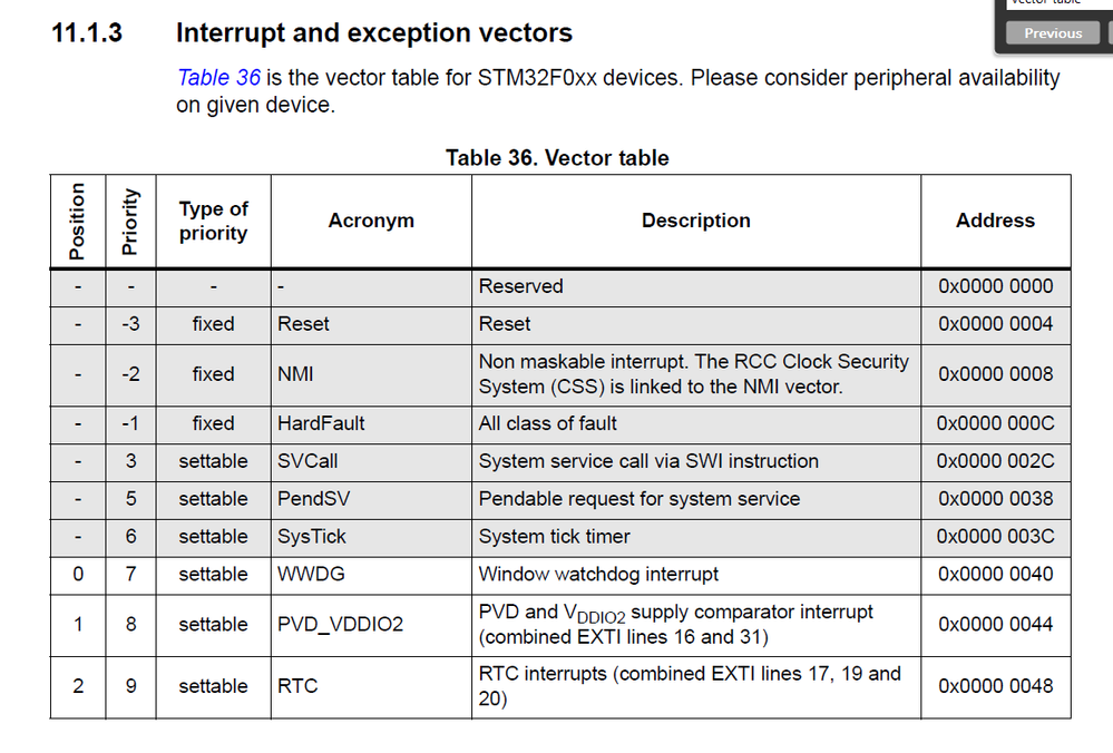

2018-06-22 3:16 AM
Looking at the Reference Manual I see that the vector table for this chip starts from 0x00000000.
Then I checked the values of these addresses and saw nothing like 0x0800 ....
This is the debuggers view of these addresses:
It seems to me that the the vector table is nit initialized at all.
