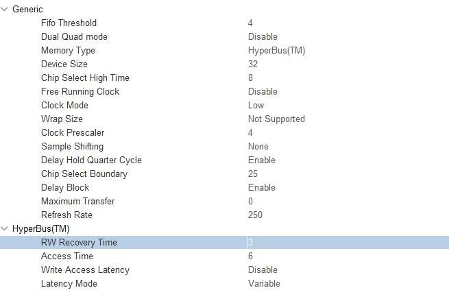

2023-04-03 4:26 PM
Thank you for answering me.
I am using the STM32H735 discovery, the problem is that the data I am reading is not the same written, it's like the data is totally corrupted. I have generated the code with STM32CUBEMX.
here is the configuration of the hyperbus memory:
2023-04-03 11:07 PM
I'm using the same board, works like a charm, memory-mapped mode.
Make sure that it's not running at more than 100 MHz.
Here's my almost non-HAL setup:
