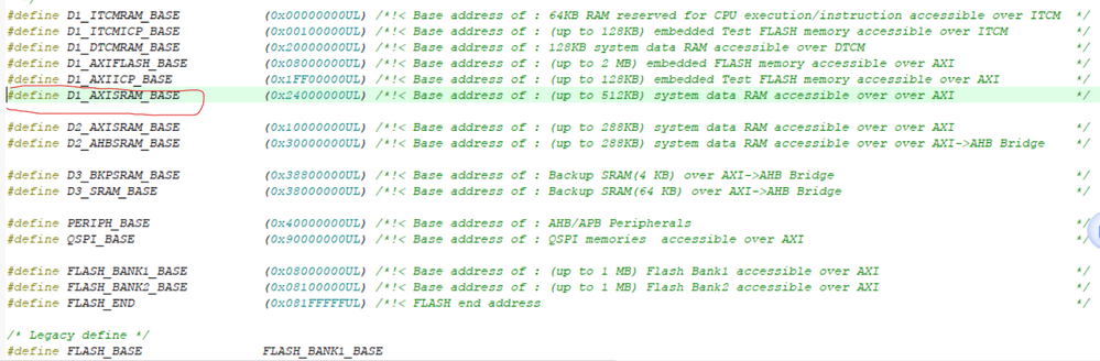

I have tried to set the buffer for receiving data a location where DMA can reach(uint32_t dcmi_data_buff[2560] __attribute__((section(".ARM.__at_0x24040000")));).
But every time I start DMA I got the same data and once I changed the location for buffer the data changed too. I also found it is the same as it was before DMA start.This seems HAL_DCMI_Start_DMA didn't work to get the data from DCMI.The data does not contain "FF D9" or "FF D8" in data so the data doesn't seem to be a jpeg photo. I wonder how to get a photo correctly.
