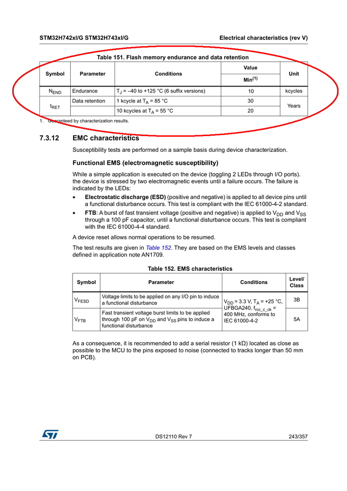

i am using stm32h743zt6 controller, what is meant by data retention in flash memory?where this parameter?how we can calculate this?
Thanks,
2020-06-27 10:08 AM
It means, how long is the programmed content of FLASH guaranteed to remain there undamaged, at given temperature )or below) and given number of erasing/programming cycles (or below).
