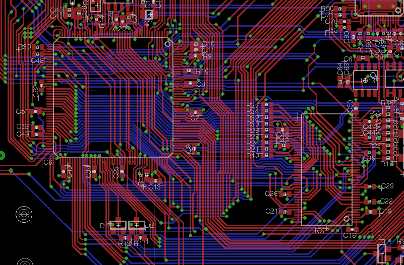

In my design I didn't care about matched trace lengths. Controller and SDRAM are about 4 cm apart. Could this be a reason?

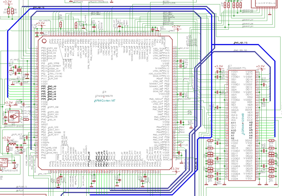

I have also attached the relevant parts of schematic and PCB.
Any help would be appreciated.
Regards
Jan
