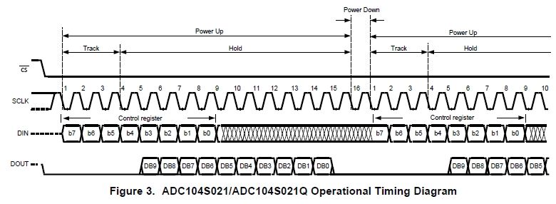

timing diagram as follows (from datasheet).

I have called HAL_SPI_TransmitReceive() API, since writing control register is overlapped with reading ADC data.

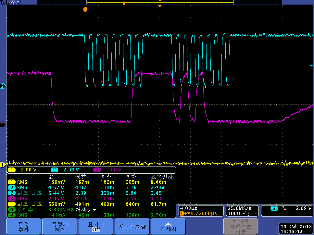

captured data from oscilloscope as follows.
As I read value from capture, it seems to be 0x2, 0x50, but printed log showed it as 0x2, 0xF9.
this is just example, all the values I've got from log are not matched with measured value from scope.
Trying test with multiple ADC values, first byte seems OK, but second byte is totally wrong.

2018-06-24 9:57 PM
Hi All,
Sorry for confusing.
It was caused by capacitor connected with DOUT pin, data is correctly received after removing capacitor.
