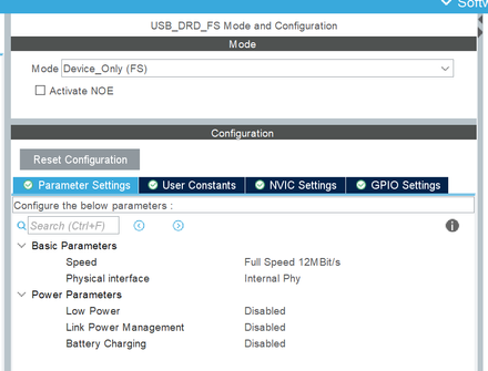

- the USB pins are enabled with the following configuration:
And the USB device mode and configuration:

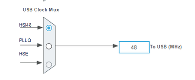

PS: unfortunately, the board does not have an HSE but only an HSI. Here is the USB clock tree:
Thank you all!

For reliable USB connection usually a crystal as clock source is needed, as given in ds , note:
So : no USB here, until you have a crystal/HSE and 3V VDD supply .
